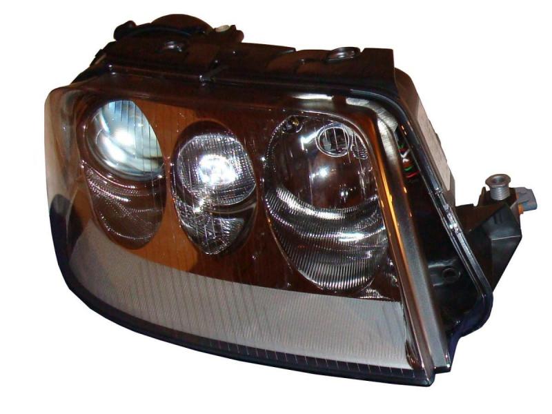

B5.5 on tehasest ka bi-xenon olemas, selle tule paigutus teine.
edit: pilt ka
