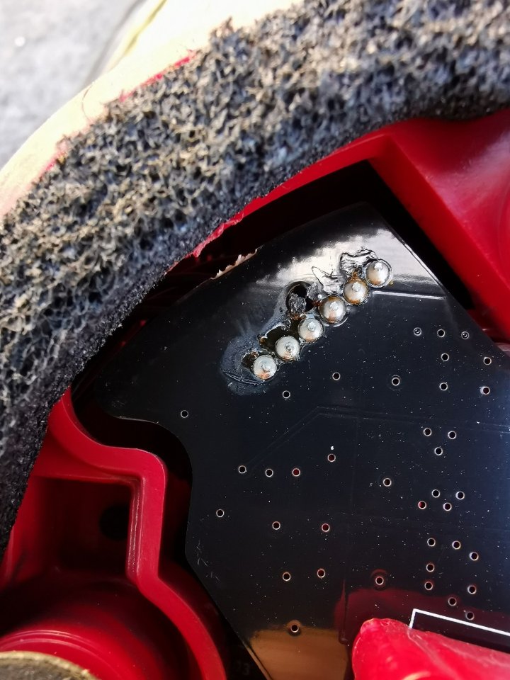

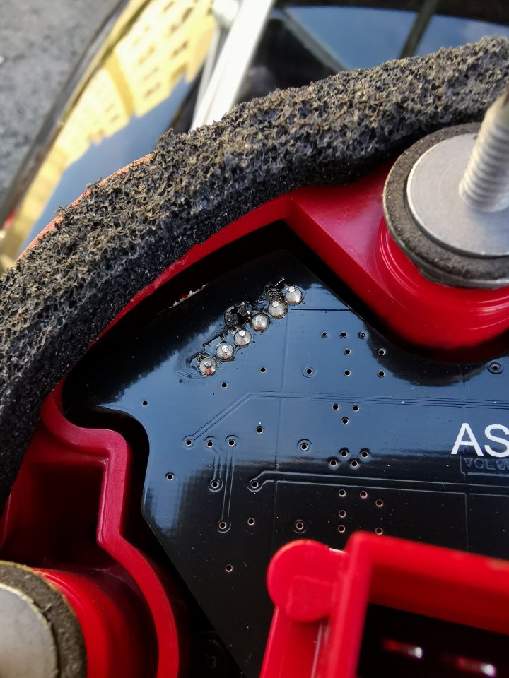

00984 - Left Tail Light (M4)
009 - Open or Short to Ground - Intermittent
00985 - Right Tail Light (M2)
00987 - Lamp for Brake Light; Left (M9)
00988 - Lamp for Brake Light; Right (M10)
