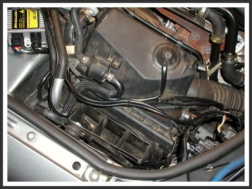

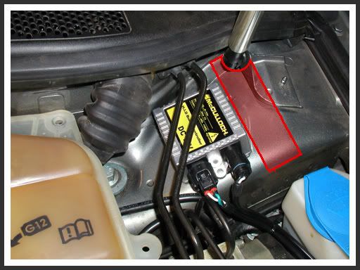

You guys with reception problems, how and where are your ballasts mounted?
I have one attached to the airbox and one attached near the headlamp, both units are mounted to plastic and the cases touch no metal (not giving the case an opportunity to ground itself.)
Ma ei oska eriti mingit seisukohta v?tta, mul kaks plokki nipukatega kinnitatud ja teised kaks umbes sarnaselt:
Kas sul originaalraadio v?i m?ni aftermarket oma ?
It may actually be that the OEM head unit isn't as good at filtering noise as aftermarket head units do..
